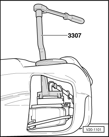

    TRANZIT, извини, я тебя запутал
    Вот нужная картинка
    ‒ → Turn fuel delivery unit approx. 15° anti-clockwise onto stop with spanner 3307 and remove.
    Note:
    If the delivery unit is to be renewed then drain old delivery unit before disposal.
    Installing
    ‒ Installation of the fuel delivery unit is carried out in the reverse order.
    Нужно повернуть против часовой на 15 градусов.
