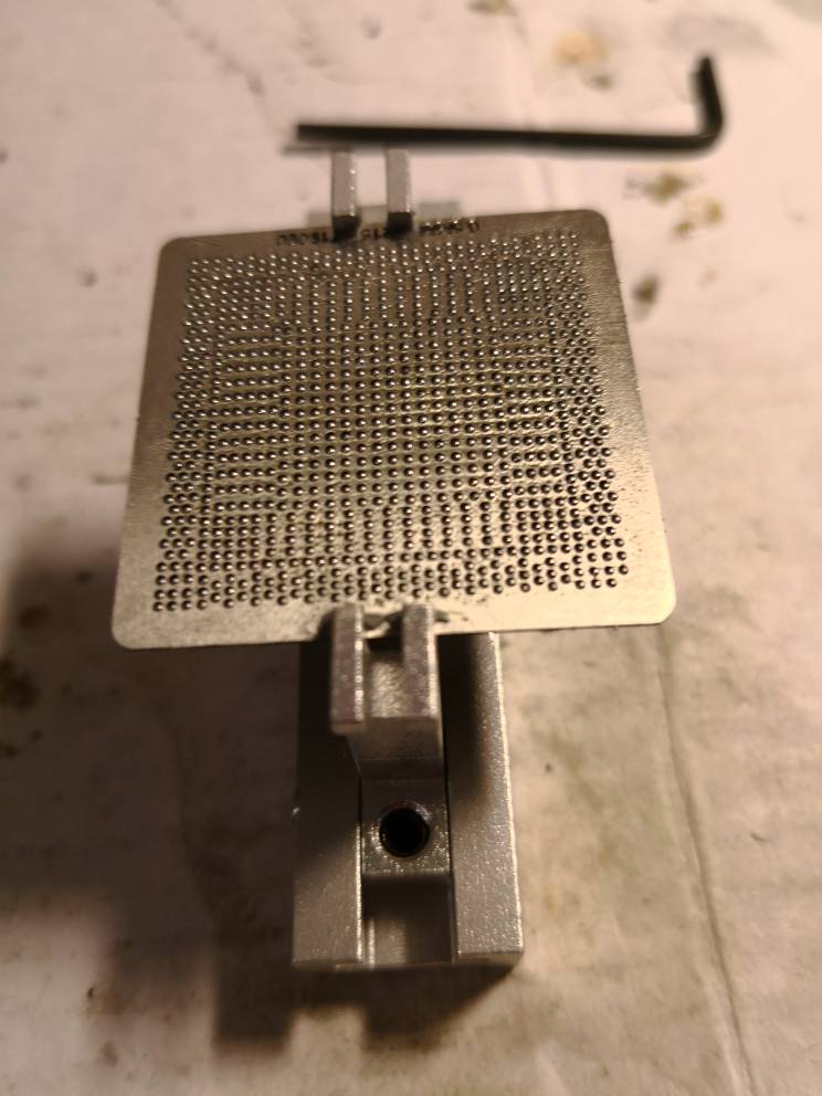

    ded_491,
    Видео чип AMD
    Sent from my BLA-L29 using Tapatalk
