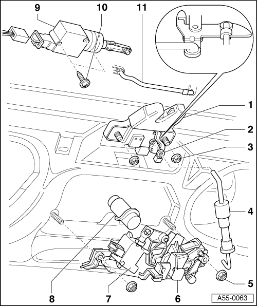

    Скиньте приз описание и картинку из Эльзы, как снять замок с пятой двери на моей Ауди. Проблема состоит в отсоединении ручек, за которые тянешь, чтобы дверь открыть снаружи.
    это ? -
    Removing and installing rear lid actuator
    1 - Release handle (Unfasten catch and pull out release handle)
    2 - Seal
    3 - Actuator
    Removing:
    – Remove rear lid trim.
    – Remove locking system.
    – Use screwdriver to press in fastener at left operating lever in -direction of arrow A- and thus release catch.
    – Pull left operating lever downwards out of handle mechanism.
    – Unscrew cross-head bolts -arrows B- and detach actuator.
    4 - Handle mechanism
    5 - Lock cylinder (Moulded seal )
    Removing and installing rear lid lock and handle mechanism
    Notet The rear lid lock has 2 latching stages.
    t Given correct adjustment, the rear lid lock latches in the 2nd stage (main latching position).
    1 - Rear lid lock
    q Swivel out hinged lever → Item of operating rod → Item and disengage from rear lid lock.
    q Unscrew hexagon nuts → Item and detach rear lid lock.
    2 - Hinged lever
    q Swivel over operating rod after installing rear lid lock.
    3 - Hexagon nut - 8 Nm
    4 - Operating rod
    q Set operating rod such that there is neither strain nor play.
    q Given correct adjustment, the rear lid lock must engage in the 2nd stage (main latching position).
    5 - Hexagon nut - 8 Nm
    6 - Handle mechanism
    q Removing:
    – Unclip operating rod → Item from handle mechanism.
    – Unscrew nuts → Item and take out handle mechanism.
    7 - Actuator
    q Removing → Chapter
    8 - Lock cylinder
    q Removing:
    – Remove handle mechanism.
    – Remove operating lever → Chapter.
    – Take lock cylinder out of handle mechanism.
    9 - Remote release motor
    q Removing and installing → Chapter
    10 - Bolt - 1.2 Nm
    11 - Operating rod

    Все понятно. Спасибо.
