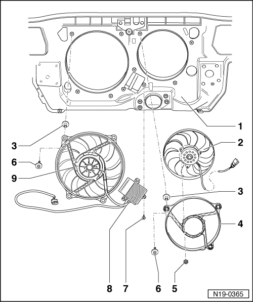

    вентиляторы :
    1.Lock carrier
    2.Radiator fan -2- -V177
    3.Securing sleeve
    4.Fan ring
    5.10 Nm
    6.10 Nm
    7.10 Nm
    8.Radiator fan control unit -J293
    9.Radiator fan -V7

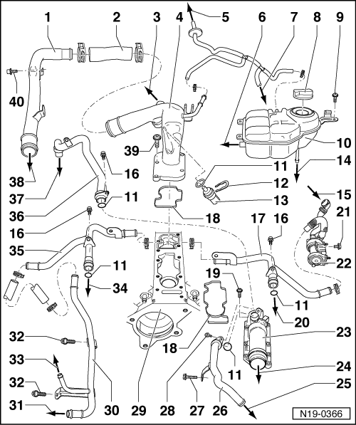

    термостат ( номер 23) :
    СВВ :
    ◆ Cylinder bank 1 is located on the right-hand side when looking forwards.
    ◆ Cylinder bank 2 is located on left-hand side when looking forwards.
    1.Pressure hose
    ◆ Ensure seated tightly
    ◆ Press together at front to release
    2.Gasket
    ◆ Renew
    3.Combi-valve
    ◆ Cylinder bank 1
    4.Combi-valve
    ◆ Cylinder bank 2
    5.Vacuum connection
    ◆ Left on upper intake pipe
    6.Flange
    ◆ On cylinder head
    7.Connection
    8.Retainer
    ◆ For oil separator
    9.8 Nm
    10.Vacuum hose
    ◆ From electro/hydraulic engine mounting solenoid valves (N144/N145)
    11.Secondary air inlet valve (N112)
    12.Non-return valve
    ◆ Note installation position
    13. Securing clip
    14. Air cleaner
    15. Secondary air pump motor (V101)
    16. 10 Nm
